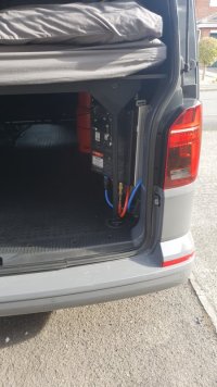

We put ours same as above mounted inside. If you turn the pump off and drain the hose there is very little water released. We just keep a microfibre cloth in the cupboard above to catch any excess. Shower works a treat.

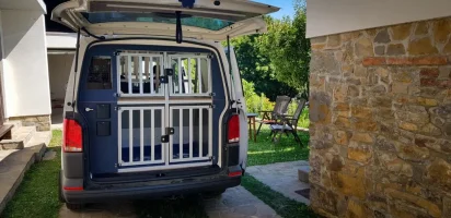

Does this water filler go to an underslung tank or over wheel arch please? Curious as to where you drill hole in floor if underslung.

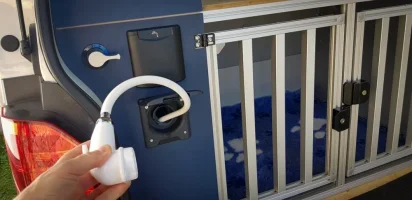

How does this filler and shower point work please? Do you have any details you can share? Thanks
The tank is underslung.
you attach a hose to the fill nozzle and fill it up.
you attach a shower hose (connected by standard hose fitting) to the shower nozzle.
Thats pretty much it. mine is just cold water but the conversion company can also fit hot water...

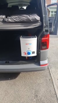

So finally got round to extending and sorting the connections from my van to the fantastic (but pricey!!) Joolca Hottap boiler/shower.
Using the underslung gas tank and an extension gas pipe with QD connectors connected up...extended the Bullfinch shower hose using a 12mm hose connector and connected to the boiler....works a treat although ill have to juggle with the flow rate to get optimum use of the onboard water storage which we don't really use for anything else....obs with a ratio of 60-40 Ricardo/Mrs Ricardo! ;)
Once the onboard water is exhausted it can be connected to the mains or with its separate 12v pump can be drawn from a container.
We shall usually set it up in a small shower tent adjacent to the van.
The only downside is its a reasonable size unit when packed up so takes up some space.(Blue box)IMG_7646.jpegIMG_7647.jpeg

Awesome piece of kit use mine every weekend mines mounted onto tv bracket! But glad you like it and I have the same ratio problem ha
Saw your set up which looks pretty cool. I guess the top of the boiler on yours doesn't give off enough heat to be of concern with the back edge of your bed?
It's on a TV bracket so tucks neatly behind leg of exploria bed then just swivel it out to use so theoretically it's outside no heat or fumes hit top of bed ?
