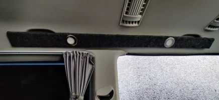

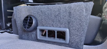

I have had an old small piece of plywood with 12v touch to switch on/off lights in my Shuttle for a few months. Now I finally bought some stretch carpet I have been able to line it and hide the wires. Might do one for the other side now too. It's not silver but a lot better than bare ply. Plus it's non permanent so I can take the van back to standard without too much cosmetic change when I eventually change the van.
