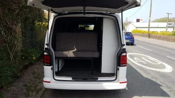

Got more interior sorted, very diy job done it all myself bar building the bed, not the most clean as a lot was first time I'd attempted but I know what do next time to make it better.
Stuff, lots and lots of stuff. And yet I still feel like I've got a never ending list of things that still need doing. Why is it taking so long? WHY???? :cry:
