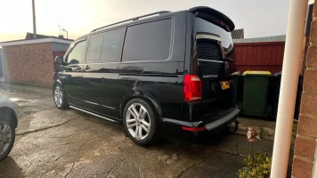

Van looks great - got to love dog dick redNot quite today, but most recent ‘additions’
Stx coilovers, supplied by @CRS Performance
And a stud +nut kit, from garagemidnight.
Also replaced the damaged wheels, for some calibre fives.
I’ve fit the coilovers myself.Van looks great - got to love dog dick red
Is that where CRS put the front coilover adjuster or did you fit them and do it?
I also have STX coilovers on my van and to get it low enough I have also wound the adjusters down on the front as low as they will go.I’ve fit the coilovers myself.
Live and learn I guess.I also have STX coilovers on my van and to get it low enough I have also wound the adjusters down on the front as low as they will go.
I think that having the coilover on its limit reduces ride quality slightly as it doesn’t have a lot of damping.
On the rear I have fitted an adjuster delete.
Pleased with it, but with hindsight I would have bought SoLow NSL.

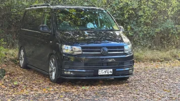

Have you got a pic of the bus from the side? I’ve got the same but isn’t low enough for meI also have STX coilovers on my van and to get it low enough I have also wound the adjusters down on the front as low as they will go.
I’m prob mm’s off that, I think I’d prefer the h&r,s to get another 20mm such a shame my stx don’t go that bit further cheers for pics tho bud
I like the way my van sits, but it’s a compromise being at the limit on the front and needing adjuster deletes for the rear. The SoLow NSLs will lower between 70-95mm out of the box.I’m prob mm’s off that, I think I’d prefer the h&r,s to get another 20mm such a shame my stx don’t go that bit further cheers for pics tho bud
Agreed, you’ve got to know when enough is enough.I like the way my van sits, but it’s a compromise being at the limit on the front and needing adjuster deletes for the rear. The SoLow NSLs will lower between 70-95mm out of the box.
The STX are supposedly 35-65mm and I’m down nearly 70 at the front and 75 at the back.
My thoughts are it would be better to be at 85mm down on the NSLs and therefore still right in the middle of the range which would be working efficiently e.g. comfortably.

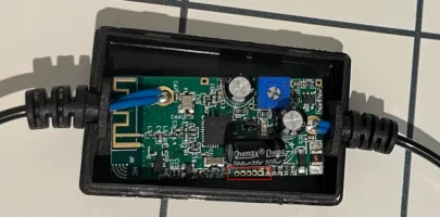

The electrical load of a BM2 is negligible but seeing one without a fuse (having seen a picture of the rather minimalist separation and cable relief inside) makes me twitch a little. On the upside if anything lets go the thin wires are likely to act as fuses before things get too carried away but still...I know some electrical gurus may suggest that nothing should be bolted to the battery negative post, but if @Loz & @Dellmassive both advise that it's ok, then that is good enough for me...![]()

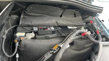

Whilst it was sunny, I fitted a BM2 monitor to the T6 starter battery terminals this morning, kindly delivered by the big red coated man wearing a white beard yesterday.
It's nice to know that the Chief Advisor very thoughtfully remembered that a Ablemail AMT12-2 trickle charger was installed a week before Christmas by the good folk @AJCConversions, so this little box of tricks will show me state of charge etc.
I have 4 of these now on different flavoured batteries and they are a brilliant, cheap bit of kit.
This 1:
Fitted here:
To monitor this:
AMT12-2 Trickle Charger charges Vehicle Battery from Leisure Battery with Solar Charger /Mains Hookup or only a Secondary Battery - Ablemail Electronics
The AMT12-2 Trickle Charger, Battery Maintainer, Battery Equaliser keeps Vehicle Battery charged during Vehicle, Boat & Motorhome inactivity.ablemail.co.uk
