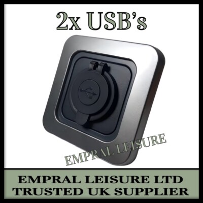

And is the 12 volt socket I posted in first post ok to use?
Personally I prefer bolted to the roof. However, sometimes this is not possible due to insulation and ceiling coverings. Many have used with great success glued brackets. Preparation is most important when the brackets are glued with sikaflex 512 or the stronger 521-522. They all good adhesives, as long as you follow the manufacturer instructions thoroughly.
Socket, i have no experience with that type. I go for branded CBE, individual. Not a panel.

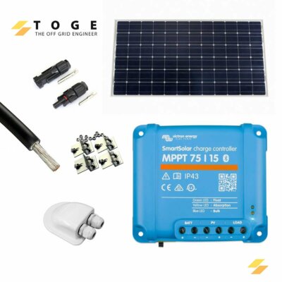

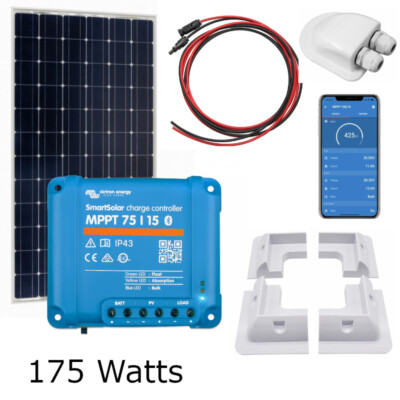

Hi Pete,
The kits I've looked at come with one as in the photos
I had one of them controllers and it lasted less than a year. my Victron 75/15 controller is great. I have a had a 100W rigid solar panel on my van since new (4 years). It had to ne changed out once already and the new one is deteriorating. I think it is the constant rattling it gets during travel.
My advice FWIW is get a portable suitcase model if possible and affordable. @Dellmassive has done a number of posts in the forum along with a couple of other guys.
Thank you for the reply. It’s always best to go with grid tie panels as they stand a good chance to outlive the van, but I understand this is not always possible. In the small panel category it’s victron, miasol and not many other accredited panels. On grid tie panels used with mppt it’s best option, but limited by roof space for some, and sometimes payload.
