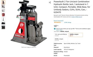

Jumping in to give some information on a product which I’ve just got and which I think is very good.
There are 2 sizes of this. They’re American so rated in LBS. 6000LBS (2721kg) which is the big one and 4000LBS (1814kg) which is the small one.
I HAVE THE SMALL ONE 4000LBS (1.8ton)
I tested it out today.
My van has just had a swamper conversion done and is now running 235/65/17 on 35mm lifted suspension. The jacking points on the chassis are now approx 12” off the ground. The larger 6000lbs jack could fit under as it‘s minimum is 11”. Except that it wouldn’t get under if I had a flat tyre. Hence the small one Which goes as low as 8 5/8”.
I have a square of 18mm ply which I sit the jack on as my drive is currently un-finished.
There’s about 1.5” between the trye and the jack.
On lowest setting with fully inflated tyres the top of the jack is about 3” under the jacking point
Pin inserted into 3rd hole on extender. Now about 1/2 inch under jacking point
Jack has latching points which lock as you rise. At full extension locked into 5th latch the tyre is about 2” off the ground.
So it’s worth noting that if I did have a tyre which was fully deflated I might struggle to get the jack under but to compensate for that I have extra pieces of ply to drive the wheel on to to gain a bit of extra height.
With the jack at it’s lowest setting the tyre was still rubbing the floor a bit. It would be ok on the first hole of the jack.
I also carry a tyre inflator so if I had a slow puncture I’d inflate it to get the jack under.
Hope some of you find this helpful.
It also fits very neatly either under the rear bench in my kombi or in side storage compartments installed by Unique Vans in St Neots.
