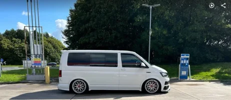

This is my ride height on air and get even tyre wear with non adjustable bushes. BTW not sure i would trust Kiwk Fit to fit a valve cap.
