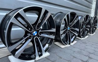

I find for my T6 18’’ wheels. This is the rim I want bmw style 397 and 255/45/R18 tire. That rim specs
8Jx18 5x120 ET34. Will the rims overflow from the car when I wear these bodies?
Did you check the load rating? From what I can find out it is 91, this is not high enough for a transporter. Only rated to 615kgWow, thank you. It looks nice, but why do I need spigot rings? Would it be dangerous if I wear it without that piece?
I did some research and read that even if I use a spigot rings, vibration may occur at high speeds. I'm thinking of not installing this rim, I will consider the original 18'' rims. Thank you for your suggestions.The BMW wheels will have a centre bore of 74.1mm - the T6 has 65.1mm.
Spigot rings stop/reduce vibrations and a few other issues - don't drive without them.
Yes, you'll find different opinions online but for £10 just don't risk anything.
In theory the wheels hold onto the hub with the axial clamping force of the bolts but...
Load rating wasn't a big deal for me, I don't use it very heavily, but I'll still evaluate it.Did you check the load rating? From what I can find out it is 91, this is not high enough for a transporter. Only rated to 615kg
