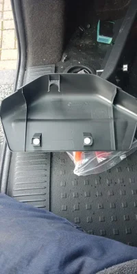

I found a picture that @Skyliner33 Posted to be very useful in allowing me not to break the trim on my rear tailgate wiper cover (as he unfortunately did)
Would a thread with pictures of where trim panel clips are around the van be useful to anyone?
I'll start with the wiper cover again.
Use of one of these tools got it off with no damage..

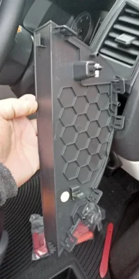

Panels on the sides of the dashboards.
Using a plastic thin wedge tool lift the front part of the panel where it meets the rubber seal first, there are a couple of angled clips top and bottom that Have to come out first.

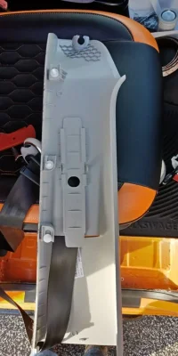

I have also broken the piece of plastic trim off the back of the drivers seat :/
T5
t5-jpg.44736
T5.1
t5-1-jpg.44735
T6
img_7199-jpg.44734
They all clip into the headlining. Here are the clips visible on mine
img_7191-jpg.44733
all courtesy @Deaky

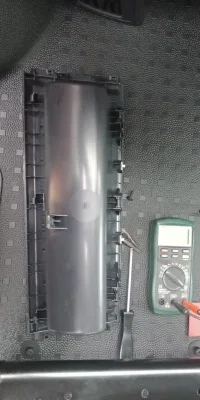

Can anyone please tell me how to to remove the piece of trim below the radio ? ( where the air con dials etc..are)
you need to take the surround around the radio off first, see one of my posts above, then you can access the panel below that and see where the clips are from above.
If I recall correctly, there was not a lot of movement available on that panel, I never removed it completely, there may have been something keeping it tied in.
I'll be very careful then, i was wanting to remove that piece and also the radio trim so i can get them wrapped
