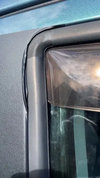

I've had a few of these B pillar decals fitted with a matt textured finish, not gloss .
The nearside fitted 4.5 years ago still looks as good as new.
The offside is a different story...
With the passenger side ok & drivers side not ok, although cut from the same batch of material, I am confident it's not a material issue...
I am on my 3rd set now, fitted by 2 different companies.
Even though fitted by 2 different companies, with the 1st company being used twice with different fitters, I am therefore confident it's not a fitting issue...
So - it can't be a material problem & it can't be a fitting problem.
I'm not sure what to do now.

After the issue with my 1st set, the ebay seller sent me another FOC - after fitting, the same happened again, only affecting the offside.
The seller seemed a genuine guy & he sounded surprise I was having a problem, with no other buyers having the same issues
I am now thinking it may be my OEM Vw wind deflector that is somehow "pushing or rubbing" the decal up?
When I fit another decal, I'll take off the deflector for a few weeks and see what happens.
I might even trim a bit off the plastic deflector where it could push or rub on the decal.
This is what happens -
