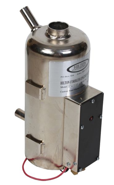

So I wanted to ask if there are any reasonable suggestions for a gas heater for coolant? Just a quick search shows that there are some options available, for example this:
I just am not sure that this is the best. What is its efficiency? Is there any chance for a small condensing boiler?
