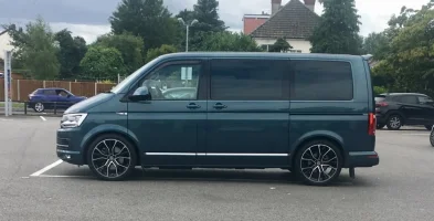

I have just changed mine after months of trawling through wheel websites, I used to be in 17" Devonports running 235/55/17 and had 25mm H & R spacers all round. I finally went for 9 x 20" running on 275 /35/ 20. which is almost bang on for the speedo
Are you still running the spacers? You still on standard suspension? What wheels you have, you have any photos?
Love the colour? Thanks for the info, appreciated.

Why did you go for in the end?
I’m interested because it shows you why you have to be careful with advice: as far as I know 275/35/20s someone suggested are only 102 load-rated… which is NOT sufficient for a T32 (needs 103+).
Despite you explicitly stating that yours was a T32!
I have exactly the same needs as you (T6 4mo T32) and my research suggests that 20” wheels just aren’t a good option: you either can’t find the right size (diameter) or right load-rating, or in rare one that has ok size and load-rating (Eg 255/40/R20) there is extremely poor choice of tyres…
I’ve decided 19” is a much better choice:
If you want low profile summer go 275/40/R19…
Or if you want a good range of tyres (summer, all-season and winter) then 255/45/R19 is a really good all-round option.
