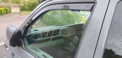

As I didn't like the idea of drilling the van bodywork, I fitted a pair of Heko deflectors which took all of 20 minutes. I can't say that I've ever noticed any wind noise or issues with closing. And here's a picture...

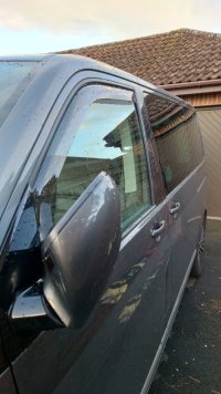

Live from the drive this evening this is a set of smoked Climair on a T6.1 Caravelle in Indium Grey
For me they don't seem to change wind noise in either a good or a bad way, but the Caravelle has the additional "sounds like a Golf" seal from factory.
