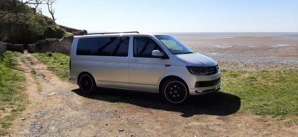

@Skyliner33 - I have sliding windows on the sliding door and also a sliding window on the opposite side. I also have 2 dummy windows mounted on to the rear quarters. Very easy to install and line up. I also cannot see any issue if you wish wished to fit the rears at a later date. I have done the entire window install on my van myself.
The only thing I am going to change is the passenger rear quarter. I am going to remove and replace this for a proper window as I would like more light into the back of the van. Mine is for a camper set up so my use may be different to yours and your opinion may differ to that.
One product that wasn't so clear when ordering my windows was the below link. Just a strip of rubber that sticks to the back of the sliding windows. Covers the gap between the front sliding and rear window. My van is Indium grey so with privacy tinted windows the grey doesn't stand out between the windows, but I imagine a white van with privacy tinted windows you would have the dark coloured window with a white stripe running down between the windows if that makes sense. Very small point but definitely something I would go back and fit and will be retro fitting.
