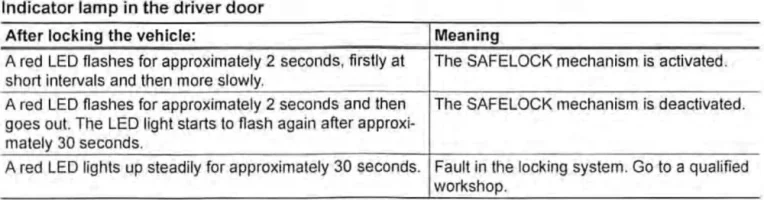

Actions are not steps.
Each line (action) is an individual way of locking the vehicle.
First 2 "actions" allow to locking with SAFE-LOCK activated and remaining three with SAFE-LOCK disabled.
First press on the key button locks with safelock (deadlocks) enabled - door can not be opened from inside or out
press the lock button on the key again and the dead locks are released - door can not be opened from outside but can be opened from inside.
Snap....
I just went out to check and when I lock the van the LED in the drivers door by the lock button does not flash at all? Tried waiting but nothing.
I guess somebody disconntected the LED when the door panel was removed and forgot to plug it back in?

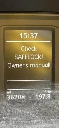

Hi All,
Any advice appreciated. Please see attached photo. Message appears at ignition turn off.
My question, like me, is simple - What does this actually mean?
Many Thanks
Radar
It means when you lock the doors they will be deadlocked and unable to be opened from inside. Press the lock button on the key again to release the deadlock

My apologies. I assumed I was being so personally dense that no-one else would have this question. I did, in my defence, actually RTFM but afterwards I was none the wiser.
Thanks again.
Blimey. That was lightning fast. Many thanks.
I figured it was 'advice' rather than a 'warning' but I wish they didn't use capitals and ! marks.
I was aware of the deadlocking etc but not that the message related to that in an informational way.
Thanks again.
