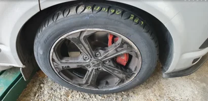

@Dellmassive, just come across this thread as I'm in need of tyres soon. Are you still running them?Had a screw in the shoulder of the NSF tyre (vanco conti`s) which i repaired myself with the tyre knots couple of months ago.
it started leaking the other day and tyre shop wouldn't repair it. . . . . (no repairs on shoulder/side wall) =[
so new tyre needed . . .
vanco conti £179 !!
mid range tyre £ 120 !!
Budget £89 !!
thats about £100 more for these 18" rims compared to the old T5.1 17" rims.
so went for the budget . . . .

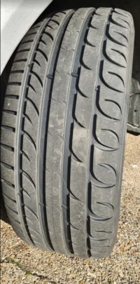

ACCELERA RADIAL
anyone had these before?
View attachment 34732 View attachment 34733 View attachment 34734 View attachment 34735
Thanks for the reply. How did you get on with them? Did they last in terms of mileage. Seeing conflicting reviews.Yes still got them on the rears....
Out of stock last time I went to garage... so the fronts are different brand currently.

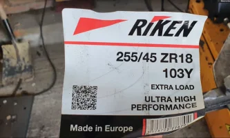

07/11/2020 | 33813 | £ 172.01 | ALLTYRES - RIKEN 245/45R18 103Y XL 2x NSF,OSF |
Thanks for the update and detailed logsLooking at my log . .
im roughly on my 3rd set of tyres at 34K miles ish.
so average for me is about 12k for a front set. (rears last longer (non driven, non steer))
MY18 204 DSG 2WD Heavy . . . .
Last set were RIKEN as no stock
04/01/20196938 £ 82.00 255/45/18/103W Accerra tyre NSF Portland tyres
11/04/201911900 £ 82.00 255/45/18/103W Accerra tyre OSF Portland tyres
08/01/2020£ 66.20 ALLTYRES - ORS tyre Accelera 245/45r18 30/01/2020£ 225.61 ALLTYRES - Accelera 245/45r18 103y nsf,osf,nsr
07/11/2020 33813£ 172.01 ALLTYRES - RIKEN 245/45R18 103Y XL 2x NSF,OSF

I liked the Accelera... a good all round cost effective tyre..
A soft tyre is more grippy, but wears quicker.
A hard tyre last longer but less grippy.
I munch through tyres every 12k ish so cost Is a major factor for me..... I'd like fancy branded tyres. But it makes no sense to me.
the vanco conties the van come with wore out just as quick as a mid budget tyre...... so why pay more?(just my personal opinion)
