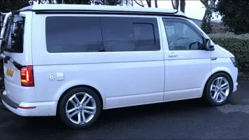

T6 T32 Currently running OEM 17” Devonports with Conti Tyres. fancying a change but what to?
Got OEM sportsline springs and Koni shocks so roughly 40mm drop
was looking at sticking with the Devonports and grabbing a matching set of spares but now thinking going for something different as you do!
been searching sales forum and came close to some 20’s but having checked with Direct Line Van Insurance they will only cover +2” over standard. Given I am mid policy and it was competitive I am reluctant to cancel and start again.
My van is Indium Grey Kombi with OEM Chrome side bars so suspect silver or maybe grey will go better than black.
Any advice or pointers?
Any Indium Grey pics with Chrome bars and alternative coloured wheels?
Anyone selling any 18 or 19 sets with decent tyres?
Are the VW Sportsline wheels an option?
any help or advice appreciated

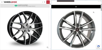

Hi, im in the same position myself. Im going for 18`s but as to which make or style, nightmare!! im not going black, and leaning towards silver after someone here pointed out that diamond cut alloys, after time, suffer from degradation of the lacquered surface, something called !"wheel worm" I believe!
My personal choice is the Calibre -Exiles or Wolfrace Dortmunds, both diamond cut (first pic) or Wolfrace X10 in silver, not diamond cut.
Well the fact that you’re only allowed to go +2 isn’t really an issue since, for a T32, there aren’t really any good (load-rated) options in 20” tyres anyway. Without going (IMHO) excessively big like 275/40/R20.
So 18” or 19” is good! Depends perhaps on usage & style:
In 19” there is a really good sweet spot for a wider sporty tyre at 255/45/R19 (basically like the standard 18” Sportline but without looking as undersized as they do!).
Or in 18” if you prefer a less wide and low-profile sporty look (although note the above is not stupidly low profile by any means) which can work well with more swamper tyre look but also looks good generally then look at 235/55/R18.
There’s also the OEM Sportline standard 255/45/R18 but I and many others think it looks a little under-tyred - ie just a wee bit too small - since it’s actually smaller than the standard eg 215/60/R17s. Good for acceleration I suppose (given gearing).
