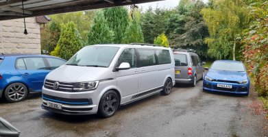

I’ll post a pic of my new 18s next weekend when I get them fitted cheers

Do you have a picture of your setup you could share? I'm trying to decide between 235/50 and 235/55. Thanks
