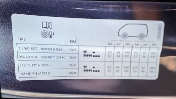

My wife has a new T6.1 camper conversion fitted with 255/45 18 tyres, I am finding the pressures a little confusing
on the van label loaded pressure 48psi all around
light load 44psi front and 36psi rear
I am thinking all the Campervan conversion kit must weigh a fair before adding 2 dogs and 2 adults but 48psi seems too high, any advise welcome

I have a 2017 T6 with 255/45R18 Landsail tyres on the front. The max pressure shown on the tyre is 44PSI and the recommended pressure according to the door frame sticker is also 44PSI.
Is this right?
Rears and other tyres on other vehicles I have show the recommended pressure to be a lot lower than the max shown on the tyre.
I’ve set them to 40PSI for now as not sure the normal pressure should be so close to the tyre max.
Any thoughts or am I worrying over nothing?
Sounds like they may have too low a load rating hence the low(ish) max pressure. What is the load rating on the side? e.g. 103.
Edit - as an example my Continental All Seasons in the same size are 103 rated and have a max pressure of 51psi.
