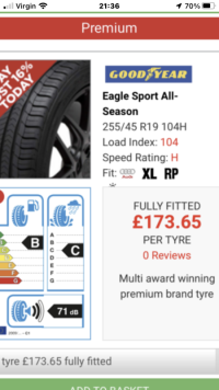

After a lot of research I decided on these as they are all season tyres the price is probably mor as this was a couple of years ago.
I really like them and my Speedo is bang on the gps
Thx Dave. As it happens I've now got some Goodyear Eagles on order - they were a little more than the Avons but seemed to come out pretty well in reviews.
