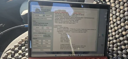

Got this Telematics error the other day. Cleared it first with Carista and then with VCDS, but it keeps coming back. On the dash.
Vehicle says everything is fine and there are no warning lights, but there's a periodic chime that's low and pings 3x.
Traveling in South America. Any specific instructions would be appreciated.1000062712.jpg1000062715.jpg1000062726.jpg1000063258.jpg
Most telematics modules have a built in backup battery.
In your case the module itself reports a fault, claiming that this battery has a 0 mAh capacity left.
Typically these batteries are 7.3V and capacity of 1390mAh.
I would try to replace it.

Just cleared these a few minutes ago
Not sure I would worry about it, if your in a country where the box has nothing to communicate too then seems little point getting overly concerned

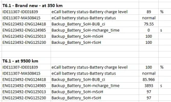

On T6.1 the battery status is available via VCDS advanced measurement values - below snippets from two different vans.
Per wiring diagram the unit 75-Telematics (J949) connects to KL30a wiring harness - thus permanent 12V there.

Address 75: Telematics (5WA 035 284 G)
12:53:04
IDE11307-IDE01839 eCall battery status-Battery charge level
99%​
IDE11307-MAS08415 eCall battery status-Battery statusnormal
ENG254564-ENG255490 Backup_Battery_SoH-BUB_ci
85.738​
ENG254564-ENG256057 Backup_Battery_SoH-mcharge_time
3625​
S
ENG254564-ENG256085 Backup_Battery_SoH-mSoH
93​
ENG254564-ENG256302 Backup_Battery_SoH-rSoH
94​
