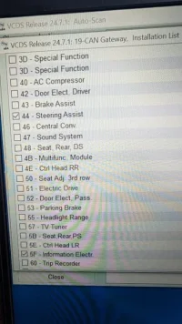

I have replaced the stock head unit for an Alpine, so wondered if that might cause some of these?
Most likely, yes.
You could try to rectify by removing the OEM 5F-Infotainment from Gateway Installation List, and replacing it by more universal 56-Radio.
VCDS > Auto-Scan > Gateway Installation List
Untick 5F-Infotainment​
Tick 56-Radio​
Save, exit VCDS​
Cycle ignition OFF - ON
Rescan to see if the situation improved
Well. Then just untick the 5F :thumbsup:
Done that and course the error no longer comes up, thank you. Now just left with the one fault. Probably nothing to worry about but would love to know/understand what is causing it.
