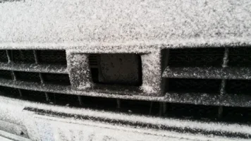

Is it possible to cover the radar like in other vw models or is there a reason for it being open? Great write up thank you.
You can cover it with something that is not interfeering with the Radar.
I think VW was just not so into the Design, since it is only a Comercial Vehicle.
Thats why they did not invest time in designing a cover ....
Up here the uncovered one works remarkably better than the covered ones. Thanks to the heater snow and icy conditions are not a problem as for the vehicles having sensor hidden behind cover/emblem.
Does anyone have a Picture from T6.1 in Snow, i read that the new ACC Sensor there is going offline as soon as a bit snow is on the road.
So probably T6.1 Sensor is not heated ?
