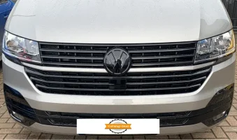

Does anyone have a Picture from T6.1 in Snow, i read that the new ACC Sensor there is going offline as soon as a bit snow is on the road.
So probably T6.1 Sensor is not heated ?
I haven't got any snowy pictures, but these photos might actually give us some indication how T6.1 ACC radar heating "doesn't work externally"
and see subsequent lack of "defrosting".
