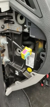

I purchased the Travelin-Lite footwell kit, and while the instructions say they cover the T6, the connectors inside the A pillar are very different.
Can anyone share some guidance on how I should be doing this?
Thanks
What @Deaky said....
That yellow plug is an airbag connector.
If the ignition was switched on with that yellow unplugged you will have an airbag light.

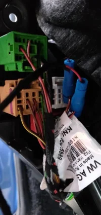

Red/black trace is +ve, brown/red trace is -ve. Not sure which plug they’re in.
Great all working is now!
For others reference the red/black and red/brown cables are in the white connector. Picture attached
