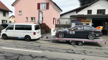

Tomorrow I will be popping mine's towing cherry - taking the race car off to be prepped for use after a 2 year gap. Our driveway has a 12% (ish) gradient - and trailer/car will be close to 2,000kg. I will let you know how well it pulls from a standing start on that gradient. (T6 150 4M DSG)
I've towed with a variety of vehicles in the past - from an old 2200 Passat through to a Disco4. My previous X3 3.0D hauled the rig up the drive from a standing start - but it wasn't exactly sympathetic. My worst experience was many moons ago, I was just about to overtake a cyclist up a steep hill when I had to pull back in due to oncoming traffic. I failed to grab a lower gear quick enough and stalled. So there I am sat in a Xtrail 2.2 - with a 2000kg trailer slung out the back - on an 11% gradient.
I left the 4wd in auto mode - applied the throttle - slipped the clutch slightly - stalled
I switched the 4wd mode to locked - applied the throttle - slipped the clutch slightly - stalled
I'm beginning to get a bit sweaty - I'm not looking forward to reversing 1km down a twisty mountain road. I have to get this thing moving.
Locked 4wd mode engaged - 3500rpm on the dial - and dumped the clutch - keeping my foot in. The tyres chirped, then bit, then chirped, then bit, and the rig was moving. Span the engine up to the redline then a quick change into 2nd and we were on our way.
Being that the T6 is Dec 2017 model I'm rather hoping that I won't need to be quite so unsympathetic - otherwise I'll have to add an even chunkier tow-car to the fleet.

Acceleration was heavily blunted but once cruising it felt strong. I didn’t check it reversing or on a very steep start.
I did miss the 55ps and 100nm of the old X3 3.0d though.
(The trailer is a brand new Fitzel - over 15,000chf / £11,000)
