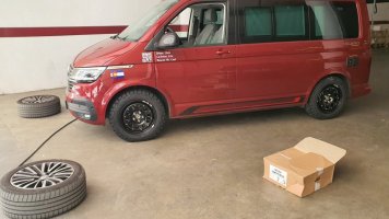

So I got the new wheels.
I told the tyre guys that the carrier will need to be adjusted to the wider setting, and may need to be inserted deflated.
I can see that the carrier hadn't been adjusted to the wider setting so I assume they just couldn't be bothered to figure it out and gave up.
I will try to make it fit myself later when I have some time.
So I finally dropped the spare wheel carrier to the wider setting. And I can confirm on my vehicle there is no way an 8" rim will fit. It would still need to drop another 10mm at least.

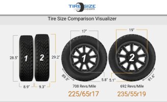

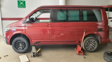

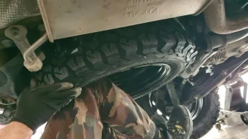

I just went from 255/45r18 from factory (no spare) to 225/65r17 BFGs on steels last week. No suspension lift, better sidewall height, and 5th/spare wheel fits underneath - I need to buy a bar. Speedo and gps/nav now in synch.
This Friday I'm taking to 4x4 training course so we'll see how non-lifted van does in terrain with respect to any rubbing.
I used www.tiresize.com to compare tires, and www.WillTheyFit.com to look at rims and ET offset.
The last image compares my new tires to the ones you're planning (I added sizes in orange text).
