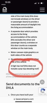

Don't waste your time trying to reclassify your van - the classification shown on the V5C is irrelevant provided your van meets the definition of a Motor Caravan, as specified by Type Approval Regs.
Read this thread...
Read this thread...

Have you actually read this?
I have read the thread, and understand the contents. I suppose with many things like this, people have a different interpretation as to what this in reality means. I shall take the advice in the thread unless anyone can prove that it’s wrong
Nick
Nick
As already said. Unless you buy a factory built California, most, if not all of the vans/campers/conversions will have gone down the PV-camper conversion route as explained in the article. There may be the odd converter out there who can obtain unregistered vans, convert them & register them as Motor Caravans at 1st registration. Personally I don’t know of any. As explained in the article, there’s no advantage in having a van registered as a motor caravan at 1st reg. It would attract a much higher rate of road tax based on the value of the vehicle. The DVLA started all this around 4 years ago when they changed their policy of re-classifying conversions as MCs. There was a big panic in the industry & some of the big players kicked off. But it soon became apparent that it was all fuss over nothing as previously explained. Despite this, there’s still loads of confusion from the un/mis-informed, that some folk still persist in perpetuating.
