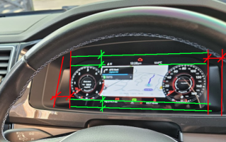

Have some questions:
- is ther any way to connect OEM Discovery Media Pro to stream it on digital cluster?
- could anyone measure the exact size of screen, clusters, etc? to me it looks like clusters are smaller than oem analog, and whole readability is a bit less. it looks like could be bigger because there is still a space (for bigger LCD - red lines, or better bigger widget placing - green):
Is there way to control size of clusters or possibility to program widgets by your own (i.e. for developers)?
The layout you see here is the standard view for nav with screen cast plus a press on OK, Pressing ok animates your dials slightly smaller to give more screen cast real estate, another press and the dials max again and you don't see any of the left and right cast screen edges. It's a nice touch
