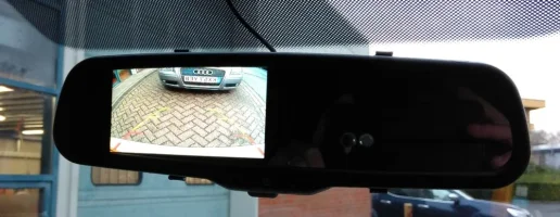

I wanted a Rear View Camera - to assist with the reversing sensors for the last couple of feet.
After a bit of research I went for this one:
https://www.amazon.co.uk/gp/product/B072KR8GMB/ref=oh_aui_detailpage_o05_s00?ie=UTF8&psc=1
I wired the Rear view mirror (with built in screen) direct to the interior light - permanent live but I am ok with that (rather that then run the wire all over the place).
The Camera sender unit wires into the reversing light (when you go into reverse, it powers the wireless camera - Black & Green Positive - Brown Negative (check yours)).
Took a couple of hours to fit - overall I'm very happy with it - it does what I wanted.
View attachment 18406 View attachment 18407

I had wired the rear view mirror the other night, so I did a quick test using a battery pack on the remote sender and adjusted the angle. There's a little cutoff at the top from the camera being mounted so deep in the trim but perfectly useful range for me. A camera mounted in the high level brake light might be better if you need to see the tow hook or wider.
It has lighting built-in but with my led number plate lights and the van's reversing lights, the lighting switches off and the image is good:
