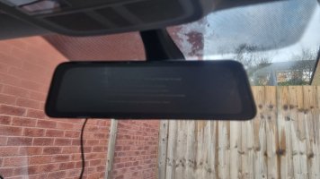

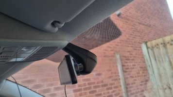

Pictures below
Perfect with bracket

How have you fitted your rear camera?
It's like a cube. I've just fitted mirror camera.
