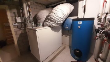

I bought a house with a heat pump but it has underfloor heating , the house is from 1995. Its extremely quiet and the unit is inside. Will get more pics later though the European systems are different to what the UK would have.
Here are some pics keep in mind it's for floor heating so a bit different so water flow temp is around 30C , I believe a radiator needs around 60-70c . Its inside in the basement so the ducts are air in and out. Today the air difference is about 8c, but that changes depending on load, requested temp etc.
BE AWARE THEY ARE POWER HUNGRY!

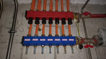

Pics are electrical control, distribution manifold for downstairs with 7 circuits, upstairs is duplicated, the storage tank , and finally the installation its 120cm square.
Jesus how BIG is your house? That plant room is bigger than our whole house!

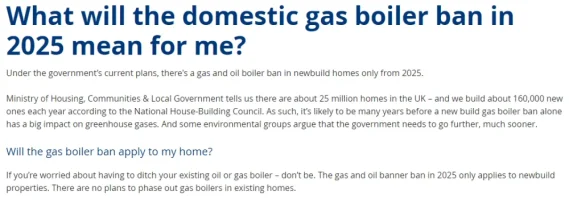

Interestingly as per David above new builds now have no real choice, as we can see no way of getting through the new building regs and sap10 with a gas boiler!
Gshp only viable on much larger houses due to installation costs
That's the conclusion I came to with my energy assessor the other day. The developer that I have designed houses for wanted to use oil for the small, rural site due to lack of mains gas. Oil would just about squeezed through the SAP before June, but not a chance now with the new regs. With sufficient insulation, some PV and a woodburner, gas will just about comply, but oil has certainly had it's day in new build.
The plant room is 15m² wide angle lens makes it look bigger. I have a nuclear fallout bunker in the basement as well , it's a Swiss thing
House is 270m² but a volume of 1400m³ but getting away from topic.. heat pump.makes place in a designed new build but not in an older house.

I was chatting to someone who says they think gas boilers will not be allowed to be installed after 2025!? Is this true? If so it may be better just to get our last bite at this cherry?

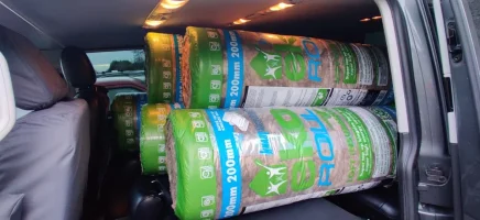

I have started on adding lots and lots of insulation to the loft. Out came the old wardrobe doors and side panels which sat on the joists with an inch of original 70s insulation. In went 10 x 200mm Eko roll today.
And as we all know the advantage of a Transporter is lots of room to collect it!
