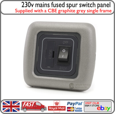

Where does the power cable feeding the boiler go to? The inverter? Is it accessible? Could just add a simple inline or wall plate switch switch at that end. 8a or 10a 240ac is not a big load to switch.
Other than that I think the remote socket idea or remote relay switch module is the simplest solution to implement.
Should be able to find a relay or socket which does 13amp or 10amp easy enough.
