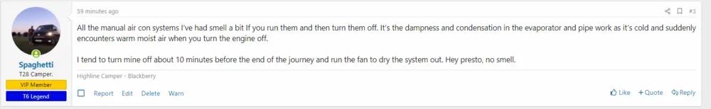

All the manual air con systems I’ve had smell a bit If you run them and then turn them off. It’s the dampness and condensation in the evaporator and pipe work as it’s cold and suddenly encounters warm moist air when you turn the engine off.
I tend to turn mine off about 10 minutes before the end of the journey and run the fan to dry the system out. Hey presto, no smell.
Spaghetti has hit the nail on the head, this usually works. The problem with the smell is, Bacteria, and live bacteria fart! well....that's how it was put to me anyhoo...? Running the fan after switching the aircon off hopefully clears the remaining condense and the bacteria have less chance.
