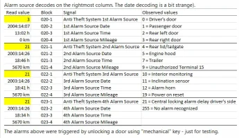

Last alarm sources are recorded in BCM measurement blocks. However, not sure if front/rear are distinguished.This may explain my alarm going off randomly.
Is this VCDS Scan still valid?I would like to keep the front installed and turned on but simply code out the rear if thats at all possible?
Just to clarify - you cleared the fault after changing the coding? And then did fault scan again?This is what I got out of carista for mine. Disabling the alarm doesn't make it go away.

Coding: A0AC393A0A61301193284F746CEB8EF40F84710F60CC6D60330400230840 (hex)
Fault codes:
03156 Sensor for Warning System Theft
It disables the internal motion sensor / alarm for the cab area, useful when camping. That said I use the door lock button on the drivers door instead.Hi guys
