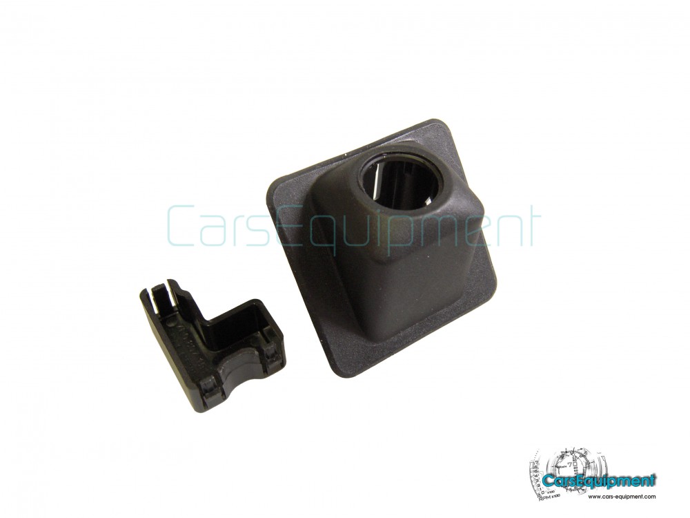

In the camera package there are attachments that I did not like aesthetically, so I made the hole in the tailgate with the Dreamel to install the Oem support. However, consider that the Alpine camera is smaller than the original one but I solved the problem by simply putting rubber shims inside the support / cover. What you see from the outside is the OEM placement in the middle of the license plate lights.
Photo for reference:

I can't photograph the inside, I have already closed the panel, you can see this from the outside. (Photo taken online, mine is the same).
Awesome, thanks.
What’s the other plastic piece that comes with the housing for?
It is used to lock the camera inside the housing, that's where you have to put some rubber or silicone to keep the camera from moving as the Alpine is smaller than the housing.
