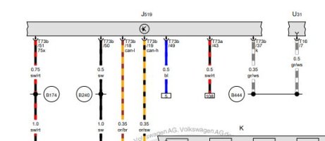

Caac Alternator diagram.JPGCaac Alt to ECU diagram.JPGcaac alt to BCM diagram.JPG
Basic connections between the alternator, ECU and BCM. Nothing listed in the CAN/LIN diagrams for my PR code (7L3) so no LIN connection there. Thank god as that would just make my life harder as I'm sure I'd find more things to modify LOL
