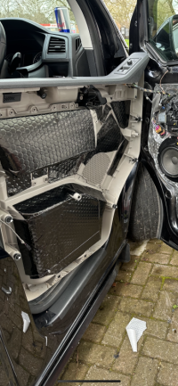

I started this earlier today. Top Door card removal tip would be to get some replacement panel clips before you tackle it. I’m not going to remove the metal panel fixed to the door itself as I don’t want to overstretch & have a nightmare I can’t get myself out of.
I plan to post some more Dodo mat in the hole behind my speaker whilst its removed before refitting with a new one. From what I’ve read on here, it’s easy enough to get your arm in & cover the biggest areas without too much hassle. I’ll go closer with the mat to the speaker once the new one is in place but didn’t want to cover over the rivets today as they’ll need drilling out eventually.
The egg box type foam will be going in on the inside of the door card once I go in for stage 2. But chucked some different Dodo mat on there for now.
Hope this helps :thumbsup:

Is the Red Bull essential?
Has anyone got pictures of sound deadening on a T6.1? I've been lead to believe there isn't much room to add any, but would like to know if anyone has attempted this.
