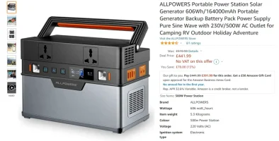

Just looking at leisure/portable power options and noticed the ALLPOWERS 606wh is on offer again (there's a £100 voucher taking it down to £439).
Another year in, how are you getting on with yours @Dellmassive?
Yep it's all good...
Though I've moved on to bigger and better units.....
Anker, Bluetti, Ecoflow etc.
