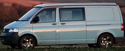

I managed an old tyre pic of bus as well.......these are 255/45.r18 103...........naturally at sunset...........old girl is preddy huh for a 200.000 miles bargain basement bus....lol I'm shy don't share many bus piccies, should share the odd one though most of you will never see steiinblau in the flesh
52752243823_e4a03a40a9_b.jpg_S2I3955 by Stuart Philpott, on Flickr
forgive tight crop if I show folk where I am they come and kill my hares:(
Back to tyres...255 to 235 worried me 235 less contact with tarmac 45 to 55 also worried me more side wall has to have a compromise to a pushed corner. Well so far these michelin cross climate 2's simply amaze me
. Be aware I'm never really been able to have prima donna tyres before, ha an' I paid not so much for 'em it was a steal. I have not driven in snow but in serious OMG floded conditions hell yeah, an dry. They seem to translate me as a driver from wheel to tarmac. For a guy that feels we as a nation , thrive on mediocrity I have to take me hat off to michelin ......didn't honestly think I'd say this...just needed new tyres and at the price couldn't resist.
