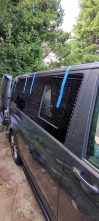

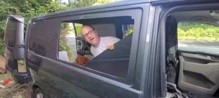

I will humbly and gratefully accept your offer of window suckers please if you wanna DM me your address. I'm gonna use the jigsaw for cutting as I am very used to it - will definitely mask up more and put more protection in place for the bodywork this time though.
I was gonna go complete maverick and manhandle them on but when I did the back windows there was a level of anxiety present I thought I could handle but when I realized the chip in one of the windows AFTER I'd set it in, I lost my cool and may have sworn and self deprecated for not being thorough enough to check the glass before I 'cut in' as it were.
I contacted Kiravans to complain and to be fair they immediately offered to send a replacement window - I went stubborn on them and demanded a refund though... kinda wished I'd accepted the replacement now but yeah... I should really have bought all the bits for this separately and locally maybe. I feel they were a bit tight with the sound deadening as I had hoped there'd be enough left to do some of the cab floor, behind the skuttle and the wheel arches. meh

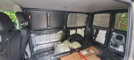

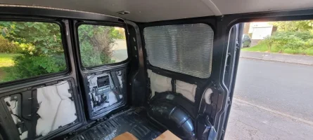

Okay so update and ideas below
tonight and over the next two days and also on friday and maybe even sat morning I am going to finish sound deadening, clean front cab and paint bare metal from the bulkhead removal job, clean everywhere in the rear, sound proof vapour barrier in, insulation in, cut old wall panels down to create two rear side panels and two barn door panels and possibly even sliding door panel, set up awning as shelter for cutting out window on O/S and cut it out, carpet line O/S interior steel, install window trim to cover carpet, install window, then do same with N/S on sliding door, install hidden trim clips and carpet line panels all round and install, buy two sheets of 2440 x 1220 ply (width tbc) and cut out for floor, buy some cheap lino for intial flooring.
