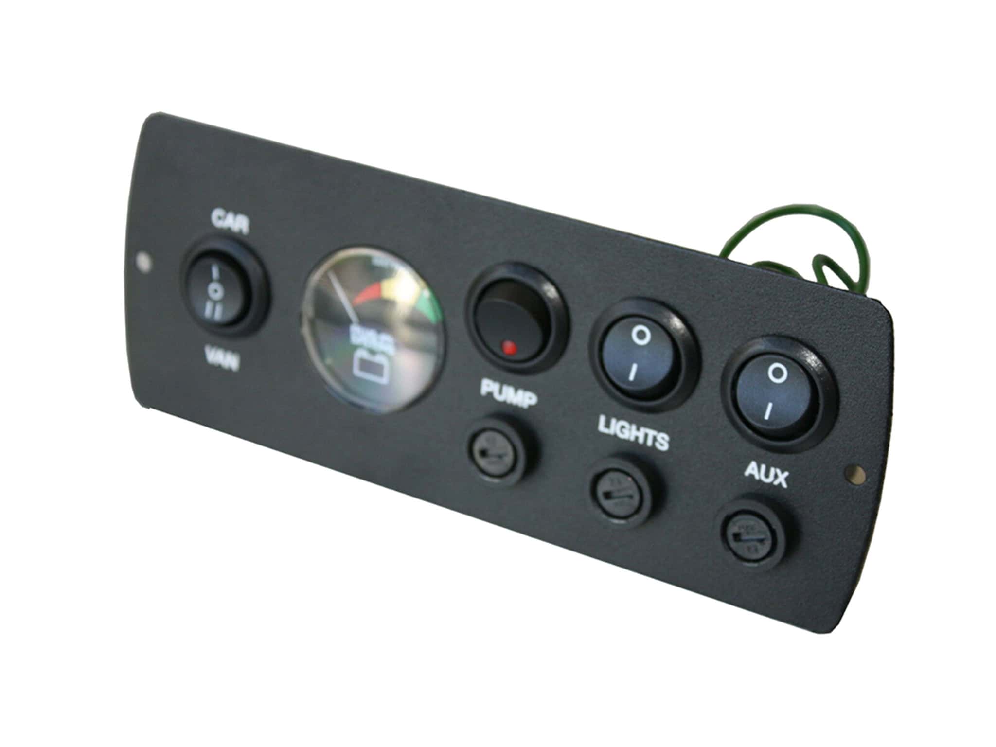

I have this panel in my campervan, the switch for the battery has two settings, see photo, CAR (top) and VAN (bottom). Is it correct that the VAN means the vehicle battery and the CAR means the (caravan) leisure battery. Why don't they make this clear.
Can I charge them from mains, and if so do I need to do this if the needle points to green (as it does at the moment). Do I need to give it a quick top-up for the winter at all.
I don’t have that unit, but I would imagine Car means the Vehicle Starter Battery and Van means the Leisure Battery. Car meaning car and Van being Caravan, is where I think they are with the labels.

Here is the full panel, maybe there is no leisure battery, maybe just one which supplies the Van, and it switches to Leisure, but I don't know............

That panel suggests you can pull power from the 'van' or 'car' battery or switch to off.
What does the meter show if switched to car?
Do the camper lights work when switched to either and do they go off when switched to 0?
If switched to CAR the needle is still in the green area but not quite as high as when switched to VAN. I have just been out to try it and if the LIGHTS switch (on the panel) is ON then the campervan interior lights will come on whether switched to VAN or CAR.
But I still don't understand what the difference between VAN and CAR :) are there two batteries
It's a Leisuredrive.
CAR = the vehicle starter battery.
You would normally not use this, only if you have flattened the Leisure battery.
VAN = Leisure battery, under the seats somewhere.
This is what you should normally have switched on, all your habitation lights, pump etc should run from the Leisure.
The mains 240v battery charger will ONLY charge the Leisure battery.
The Leisure battery will also charge from the Split Charge Relay when driving.

The Vehicle starter battery (CAR) will be charged, but the Split Relay will also charge the Leisure battery (VAN), effectively treating them as one.
You don't need the control panel on but you can check that both the batteries are charging, the needle should be well into the green.
If you don't drive the van for a couple of weeks then use the CTEK. We use it every couple of weeks through the winter if we are not away in the van.
Finally, turn off the switch (centre position) when not in use.
And remember to switch the Leisuredrive mains battery charger back on before you next go to a campsite!

The Leisure battery (VAN) is probably fine not being charged, but charging it will extend it's life;
The vehicle battery (CAR) will have low current drains (alarms etc.) and can run low if not used for a few weeks.
