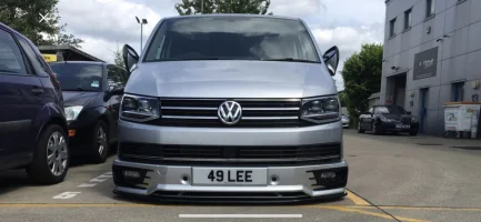

It's finally arrived..
WOC splitter.
Any advice or tips for fitting?
It just come in a box with some allen bolts and nuts.
Best way to line it up or is it plainly obvious?
Here we Go then . . . . .
WOC Front Splitter Install.
Get it up on ramps for more clearance underneath . . . .
Doing it on my own so, roughly line it up and clamp in place . . . .
Check for clearance and space behind each panel and drill out a 6mm hole . . . .
The kit didn't come with any washers, so i added 6mm penny washers where i could (seems the Maxton kit comes with washers/instructions/stickers etc . . . Not the WOC one tho)
getting off the ramp was a bit close, but ok in the end . . . . about 10mm clearance!
final fittment and check . . . .
Looking good, i think this setup looks more classy than the OEM Sportline splitter . . . in reflex silver at least .
And a quick vid of the final fitting . . . .
