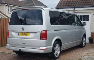

Totally agree with you on that one can I ask what size tyres are you running on the front
You might find they scrub on the fronts mate, depending on your wheel width and offset.
275 on fronts are pretty wide.
I have velar VLR04 20
8.5 front
10 backs
And on b14s and needing 4 new tyres now and want to get it right as fronts are rubbing way to much so asking for advice from you all
8.5 front
10 backs
8.5" fronts, I would personally be going 255 or even 245. The wheels you asked about above on mine were 8.5" ET45 with B14s wound right down, and I ran 255 and 245, neither rubbed at all.
It's no wonder you're rubbing if you have 275s on an 8.5" wheel. I'm surprised they don't look like they budge over the rim.
If I was to run 8.5" 20s, they'd be fitted with 235/35/20.
When you buy the wheels and tyres
They are sold with 275.40.20
Van style do the same deal on there web site and got to get the load rating right what should the load rating be On a T3o
102 minimum.
Welcome to the world of wheel and tyre compromises :(
Thanks I am losing the will to live
Looking on line for 255.35.20 for the fronts and keep 275.35.20 on the rear
and all the 255.35 are only load rated to 97 one step forward 6 steps backwards with me
245/45/20 are 102Y rated
235/45 are 100Y though, 265/40 are 103Y
When I had a set of Rolls Royce Ghosts I ran 245/45 on 8.5 front and 265/40 on 9.5 rear.
How low are the b14s wound down?
No not to the bottom and when I had them fitted it rubbed so I took it back and they raised it my 5 mm and still doing it
It’s rubbing on the bolt or fixing at the top of the wheel arch because I think they are to wide
