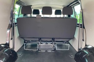

As the van is not a campervan, it is used as my daily driver, for transporting bicycles when we go for bike rides and somewhere to have a cuppa, eat a picnic, get changed and chill out, I have been thinking about what I want to do in the back….
Of the 3 different furniture and seating arrangements I had (see further up) in the last van, the simplest one was definitely the best - single passenger seat, swivelled round with a round table fixed to the bottom of the b pillar and using the Kombi bench in its standard position.
So I intend to recreate something along these lines - the last van had twin sliders and this one has a single slider so I could use the space behind the drivers seat for storage or to stow the table.
I also built various cupboards/cabinets for storage and as somewhere to mount the rear speakers in the last van.
This time, I want the area behind the Kombi bench to remain clear/open so our bikes can both stand up diagonally, so I intend to build some storage/speaker boxes underneath the Kombi bench - making use of this space will enable the rear to be clear.

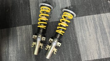

ST-X coilovers incoming. Looking forward to losing the huge arch gap o_O

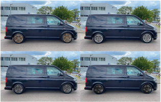

Any thoughts on these Range Rover 20s?
prefer your previous thoughts/options:
"After that will be wheels - Navis Twin 5 (virtually identical to the two sets of Amarok Canteras I had on the last van) is top of my list but also like the SuperMetal Cells. Might even go for another set of Canteras if I can find some. Would need a 15mm rear spacer if I did."

Preparing to fit the STX coilovers that arrived yesterday by spraying some bolts/nuts with wd40.

Next up was to fold back the Kombi padded floor - I removed the rear and middle load lashings, rear threshold, Jack and then temporarily folded the floor up against the back of the second row bench seat.
Hoovered the dust and fluff up and then panel wiped the whole area. Once it was dry I then stuck Silent Coat sheets across the floor until I reached the rear threshold.
Then I reinstalled the floor and load lashings and threshold and Jack.
Will sound deaden the other half of the floor from the sliding door but will need to remove the bench seat and flip that backwards.
Also removed the offside rear Kombi cardboard panel and sound deadened the metal panel and also added some smaller, odd shaped bits to the lower metal panel.
Interestingly, my Kombi already had some foam pads stuck to the lower panel above the wheel arch - I never saw this on my previous panel van so must be a vague attempt by VW to reduce the harsh van sounds in the load area of a Kombi.

Just had some Meyle HD top mounts and drop links delivered.
Intending to remove the stock struts without taking off existing spring/top mount - saves killing myself with spring compressors anyway :rolleyes:
Hopefully get started on fitting these after work today/tomorrow
What a ball ache wish I’d paid the money for someone to do it.
Oh well, got the other front one to do which should be a bit quicker as I’ve now done one.
Then the rears that look to be piss easy in comparison - might have it done by Monday lol
