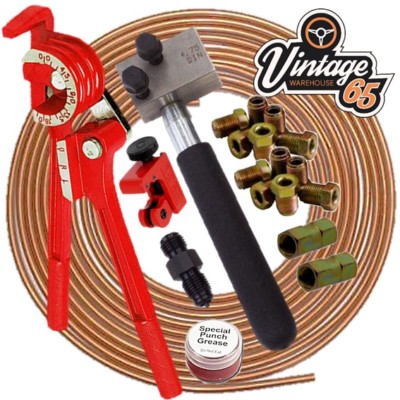

There are lots of kits on ebay with pipe, male fittings, female fittings and straight connectors.
Just need a flare tool!

I bought this kit when I was doing double flares on my Boxster. It was easier than I expected to make a flare on the hard lines, while they were attached to the car. Practice on the new stuff first. The kit also has a bending tool and some joins.
