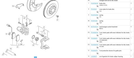

Brake pad wear indication renews with replacement pads i.e the new pads have the wear indicators built into them, just needs connecting up to the wiring on the van.
Only one pad on each side (at the front) has the wear indicator on it.
I don't recall the rear pads having a wire on them, may just be a 'squealer' that touches the disc and 'squeals' when they get low.
