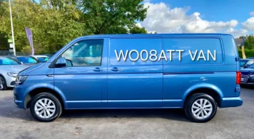

Not my first VW, but definitely my first Van. Hi everyone, I am hoping to mine valuable knowledge from the hive mind here on how to buy the important essentials (or build) as cheap as possible. I am broke after buying the van, so very limited funds for at least 6 - 12 months.
Howdy JumpShip.
I suppose the first thing I'm seeking advice on is how to have a bed & seating area. I've been looking at building a sliding jobby. The bought ones are very expensive especially with the foam cushions. I'll be in it alone most of the time, but I'd like to be able to have room for another (just in case my van becomes a babe magnet)
Lovely lookin van WO0! welcome to the forum!
