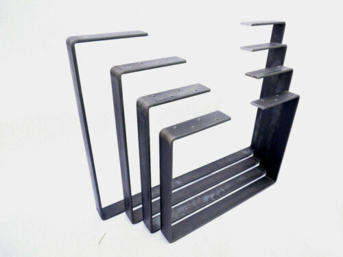

Easy to source these 4mm "coffee table frame" on ebay. Needs repainting but means I got 50% back as compensation. So all in, about £50 of hardware to support the extending bed board I made

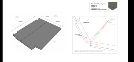

I’ve been making my own inspired by this design.
After considering all the different ways to make a bedboard, I decided this solution was the best as it allows the seat to go most of the way back without taking the board out.

@bobbybasic that looks great. At some point I will modify my bed board to be the same as this.
Be interested in how you fastened the support piece in behind the passenger side wheel arch. As well as how the board is secured to the supports.
My seat won’t slide that far back due to not clearing the wheel arch. Did you do some modifications to make yours slide so far back?
There's a thread about this, you need to trim a bit of the frame and then have the outer bit that hangs over the wheel arch cut and welded so it cants up a little like a plane wing. Depending on the tolerance you may or may not need to trim the seat foam.
