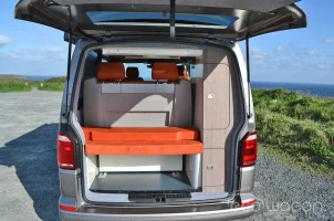

Does anyone know where you can get the bed extension ecowagon use in the pic below, or is it something they just make for their own conversions?

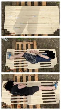

Starting to build the multiflex board and I've decided to mimic some van furniture designs so that it can be hinged behind the seat within its width when not in use and extended full width as a bed for our youngest. We don't have furniture and not about to as we put our awning and/or bikes through the length of the back of the van (we cook on a pod in the awning or bbq with friends outside)20230509_160929-COLLAGE.jpg
Hardware arrived. And parcel shelf/bed board testing well (just cantilevered on the two bars of the pallet but will add a leg for when it is extended fully)
Now to fashion some foam while I wait for the frame to arrive.
Frame arrived a while ago but last time we camped I made a wood frame for each side. With a deadline I've now done this 20230831_220516-COLLAGE.jpgPXL_20230830_182805866.jpg
Easy to source these 4mm "coffee table frame" on ebay. Needs repainting but means I got 50% back as compensation. So all in, about £50 of hardware to support the extending bed board I made
My daughter's finger has neatly anonymised this picture of me lying on the rear bed. Ran out of time to hand-stitch the pads shut. Need to change the third leg for a matching metal one... Ikea hack needed
You can tell I didn't get the alignment of the right leg onto the lower wood batten as the right hand doesn't match when closed, but functionally perfect for our camping this weekend. The third leg has a magnet catch so that it stays in place when not in use (swings up under the right hand extension). There is clearance for a low really useful box under the "parcel shelf" and the pads are 9cm, if I recall correctly.
I’ve been making my own inspired by this design.
After considering all the different ways to make a bedboard, I decided this solution was the best as it allows the seat to go most of the way back without taking the board out.
I have some VW vinyl to cover it, I’ll get a professional to do that bit.
